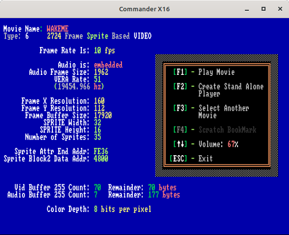

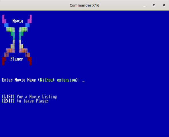

Program outputs a MOVIE.SPV & MOVIE.SVA file (Video & Audio) in a few different configurations.
These files are playable with the included PLAYMOVIE.PRG (PLAYMOVIE.BAS BASLOAD source included). Upon playing a Video the PLAYMOVIE program will give you the option of outputting a standalone PRG to play the converted movie.

BITMAP
based Videos in 1bpp, 2bpp & 4bpp are now supported. Sprite based Videos are still the default option.
(See Video_Spec document)
The Maker now actually calculates optimum Max frame rate. Before it kinda guessed.
The Maker now trys to check if the Audio Sample rate entered will result in two large Audio.
Maximum is 3096 bytes of Audio per frame.
An EXPERT MODE has been added. EXPERT MODE IS NOT currently functional for BITMAP
based Videos. Expect an interim release to fix this soon.
(Cartoons often look just as good in 4bpp or better with the higher res compressed modes)
Player supports Volume control now with up & down arrow keys.
