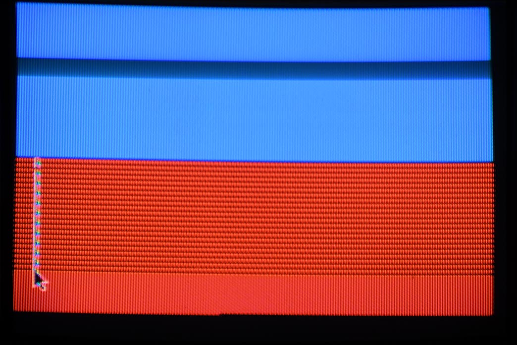

So I did a test with the mouse cursor following the interrupted scanline, and using those 169 NOPs required by NTSC and it actually looks like it worked (at double scanline 118, do one black, then one red, and so on for 22 double scanlines; set sprite Y to scanline counter):
I have no idea if there are actually cycles left inbetween those scanlines, but I really hope so.
So this test proves the (read only) scanline counter works on the real hardware.
Does NTSC work then? Possibly. I need a way to test some game logic outside of interrupt time, like another sprite moving a distance. Also I need to find when the scroll registers are latched for a particular scanline.
Attachment includes the source and program for this test, which can probably help making the emulators better (they completely fail all NTSC but also VGA timings)
