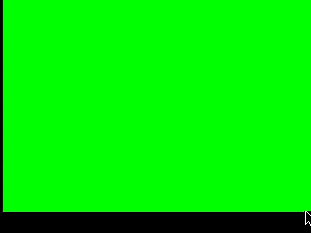

The bug is visually presented by writing this test program that can be run and easily modified. Using the backdrop palette color as test, it will give a more visual representation of the problem.
VGA is behaving as expected of the documentation. Setting a palette index such as the first (the backdrop) to a different color than set from vertical blank, during a specific scanline should change the color somewhere close to 1/3 of the screen's width of said scanline as seen in the screenshot from a capture card:
VGA
Note that 240p scaled content such as layers and sprites do snap to even pixels, but backdrop color won't since it is acting on the 480p interrupted scanline. How layer scroll values are affected by even and odd scanlines in 240p are unknown and when something works on VGA, it must also work exactly the same on NTSC (which it currently don't, play that Sonic demo on the SD card for proof).
To get a full scanline change of a backdrop color, one can use the timing of the CPU to delay the write until the raster beam has reached the end of the visible screen by inserting NOPs. In this case, 63 NOPs are inserted to give this result on VGA:
VGA
A few more NOPs and the write of the palette entry will happen in the hblank as desired. Normal game consoles allow such effects, no matter if it is NTSC or PAL (see Yoshi's Island for SNES). With these many NOPs, there are no time to run game logic between scanlines in 480p, but in 320p there are a few cycles to take advantage of.
Now to the NTSC 240p, Composite. The same code as before, the backdrop is affected much earlier. Looks like half the distance compared to VGA but that might be misleading:
Composite
When adding the same 63 NOPs to get the palette change in the next hblank, the palette change happens somewhere in the middle of the screen instead:
Composite
With these tests, we developers of games that want raster effects hope to see a unified result where a hblank is a hblank, no matter if it is VGA, Composite, S-video or HDMI.

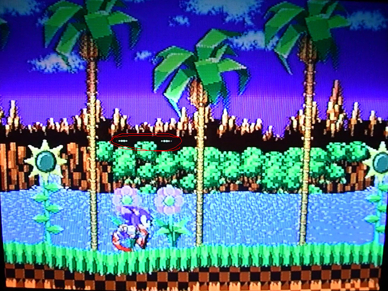

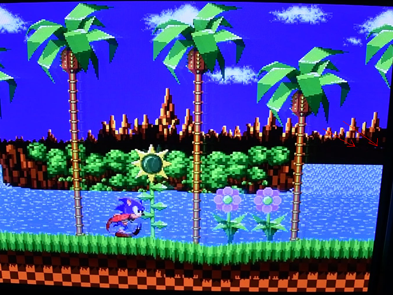

Sonic demo from the SD card (the batch from February 2025) where the latching of horizontal background layer fails and differs between video output modes:
VGA
Composite
Now to the NTSC 240p, S-video. The same code as before, the backdrop is affected much earlier. Looks like half the distance compared to VGA but that might be misleading:
S-video
S-video

Re: VGA vs. NTSC timings are not giving the same desired output
In VGA mode, there are 800 pixel clocks in a scanline.
In NTSC mode, there are 1588 instead, so that's why it looks like the timing is too short by (about) one half.
So, in NTSC mode, if you double your delay, you should be able to get your write to hit at about the same point of the scanline compared to VGA mode.
doslogo
Posts: 49
Joined: Fri Dec 20, 2024 4:26 pm
Post by doslogo »
DragWx wrote: Sun May 11, 2025 2:50 am In VGA mode, there are 800 pixel clocks in a scanline.
So every 800 pixel clocks on VGA, a LINE interrupt is fired? And on every 1588 pixel clock on NTSC, a LINE interrupt is fired?
Also, if you have a link to the FPGA code that does this LINE interrupt, I would like to have a look at it. I believe something fishy is going on.
Posts: 403
doslogo wrote: Sun May 11, 2025 3:28 pm if you have a link to the FPGA code that does this LINE interrupt, I would like to have a look at it. I believe something fishy is going on.
Sure, I'll provide links to the exact commit I'm looking at, so I can highlight the appropriate lines. (Or attempt to, anyway)
As an overview, there's a VGA core, and a separate composite (NTSC) core, and they keep track of their own timings separately, including when the next line is starting, which is important for the line IRQ. The VERA will listen to whichever core corresponds to the currently-selected video mode.
video_vga.v contains the VGA "next line" signal.
video_composite.v contains the composite "next line" signal.
Both "next line" signals are synchronized to the beginning of the active (visible) portion of the scanline.
Of the two "next line" signals, the appropriate one is selected here in top.v, depending on the current video mode.
The selected "next line" signal goes into composer.v, where it clocks the Y counter +2 if in interlaced mode, +1 otherwise.
Finally, the Y counter is compared with the line IRQ number, and the line IRQ is generated if they match. The exact time it's generated is when "next line" toggles, which is at the start of the active portion of the scanline, remember. Note that in interlaced mode, the least significant bit is ignored during the comparison.
doslogo wrote: Sun May 11, 2025 3:28 pm So every 800 pixel clocks on VGA, a LINE interrupt is fired? And on every 1588 pixel clock on NTSC, a LINE interrupt is fired?
Yes:
VGA mode uses 800 clocks during one scanline.
Composite mode uses 1588 clocks during one scanline.
So, if you fired a line IRQ on every line, they'd be spaced 800 VERA clocks apart (=256 CPU clocks) in VGA mode, and 1588 VERA clocks apart (=508.16 CPU clocks) in composite mode.
Remember that there's some amount of jitter due to the CPU needing to finish its current instruction before it can jump to its IRQ vector, and then some amount of time is consumed by the Kernal's ISR preamble before it actually jumps to CINV.
If you want to exactly synchronize with the line IRQ, then set your line IRQ to be one line early, then on interrupt, acknowledge and bump the IRQ line to the next line (or +2 in composite mode), then use the instruction WAI (leave the CPU's "I" flag set) to suspend the CPU until it happens, and then the CPU will resume execution at the beginning of the active portion of the next scanline.

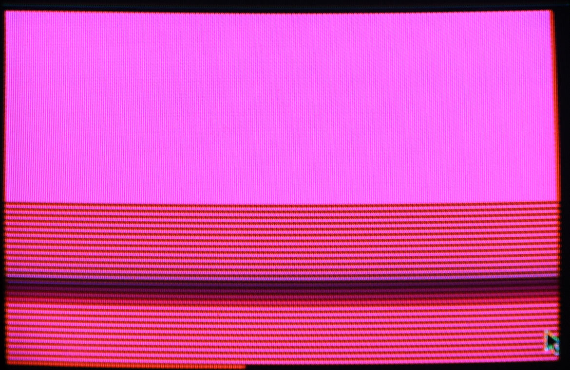

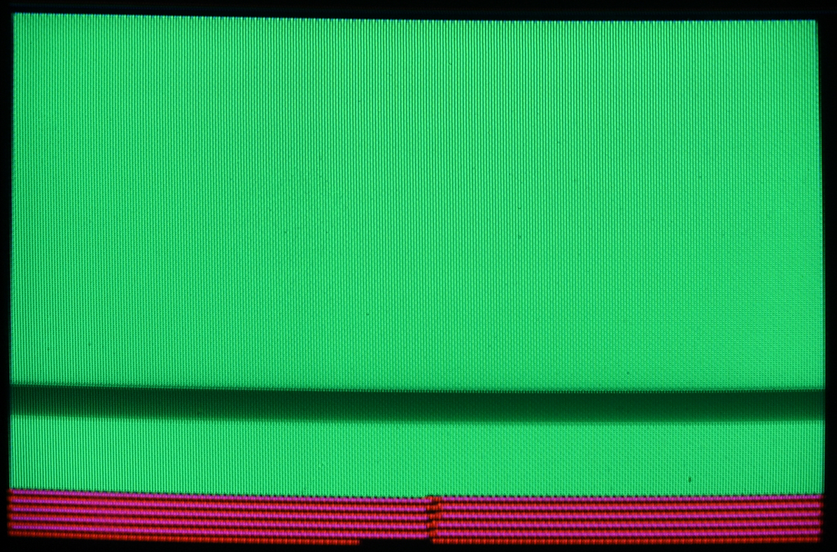

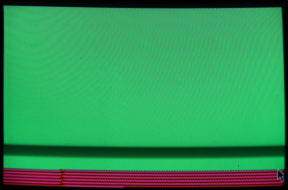

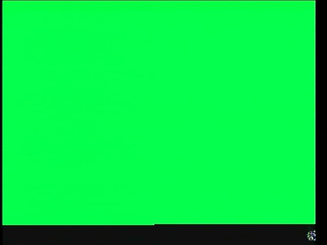

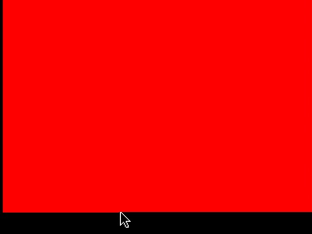

Just waiting on real hardware every +2 scanlines does this:
Green backdrop until scanline 436, then alternate black and red until vblank (240p, so interrupt every other scanline)
With one NOP of wait:
With 63 NOPs of wait, the VGA test case of NOPs:
EDIT: The green color is missing because IRQ LINE continues after vblank. The purple color is red, but my PVM had Phase set incorrectly!
And this is with 169 NOPs, the required count to finally reach the non visible screen on NTSC:
The only thing changed in the code is the number of NOPs to wait until the backdrop is changed. This is my problem: Waiting too long on a NTSC scanline will screw everything up. Also, mouse cursor disappeared in the 63 NOPs case.
If it was just a matter of waiting as long as you'd like, then why is there a purple screen and why does the alternating lines start higher up? And where did my cycles go? There is no time for anything inbetween IRQs when adding so many NOPs
