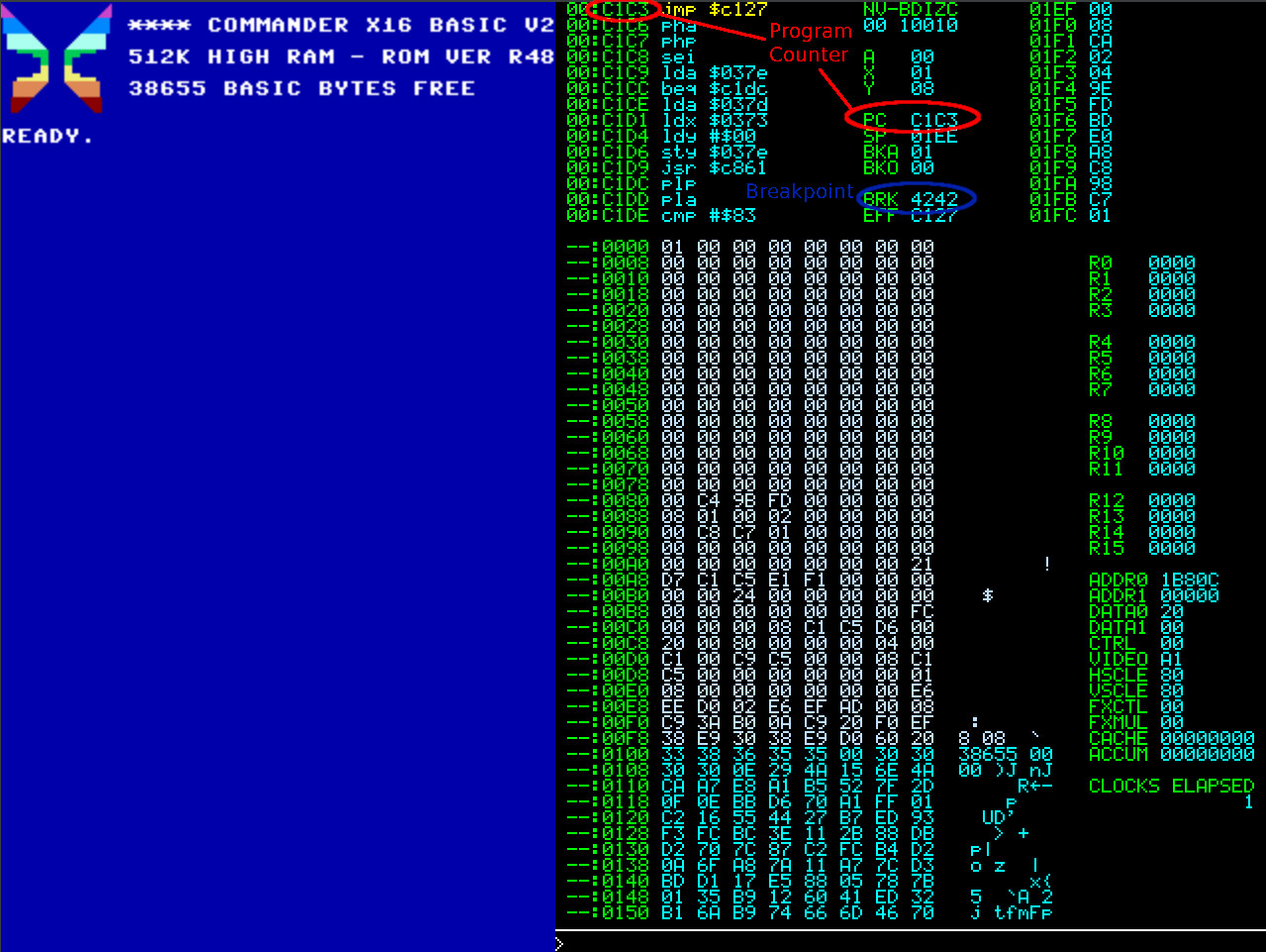

The program counter is usually the same in both places I have marked with red in above picture, but if you are in the debugger and write:
d xxxx
where xxxx is an address, you can change the codeview to start from that address. After that you can press F9 and get the breakpoint (marked with blue) set.
In your source, you should be able to just add the stp opcode, if your assembler supports it, otherwise .byte $db as you have mentioned your self. If the emulator is started with the -debug option, it will automatically enter the debugger on the code just after the stp ($db) opcode has been read.
d xxxx
where xxxx is an address, you can change the codeview to start from that address. After that you can press F9 and get the breakpoint (marked with blue) set. ...
I've never seen anything in that breakpoint except "----". Using "d 33" and hitting F9 was the second thing I tried, to try to replicate "break 33" in the VICE monitor, after "x16emu.exe -debug 33" didn't work, nor 0033. Should it have been "-debug $33"?
