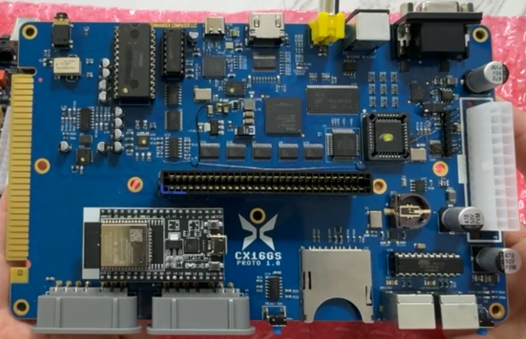

Pictures of the board (from the livestream)
Yes, that's an HDMI port up top, next to the composite video jack. The system also has a built-in wavetable synthesizer and WiFi network interface (ESP32 running Zimodem firmware.)
The system will also feature a 65C816 CPU with 32MB of RAM, directly addressable by the CPU without relying on the $00/$A000 banking system.
Otherwise, the system should function the same as the Dev system, and already runs most R48 compatible software. It should be 100% compatible by the time it hits the market.

Thanks to @Wavicle for the system component annotations.

Is the pinout of that card edge connector the same as the expansion slots? If so it would be possible to make a backplane and add more slots. Having said that given what has been added to the board I'm not really clear what I'd put on an add on card. 32MB directly accessible to the '816 bus makes this an AMAZING computer.

I asked that question last night during the livestream. David didnt have a ton of info on that bus connection but did say that it was intended to be the full bus so that a breakout backplane could be made to support additional cards later. The central slot is the same as the existing gen 1 slots as it will be used for cartridges (they are going for the gaming console motif with this one).
Whether the bus connector is the same pinout or different wasn’t clear/known though.
