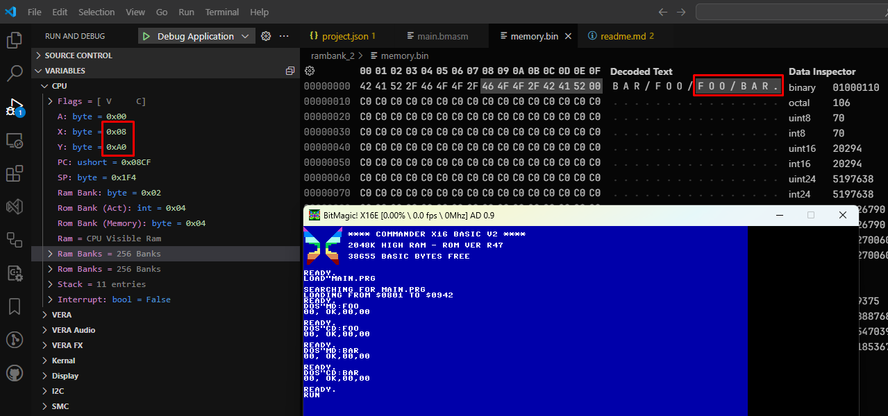

I needed to get the current directory, but found the command `$=C` difficult to use as it returns the data as displayed in the BASIC prompt. So to make this more 'machine readable' I've written the code below which will return a pointer to a string in $yyxx which is null terminated in the form that is easier to use.
I thought it might help someone else in a similar endeavour.
While tested, please do shout if there are any issues as string parsing the output of the kernel can be difficult to test every scenario.
