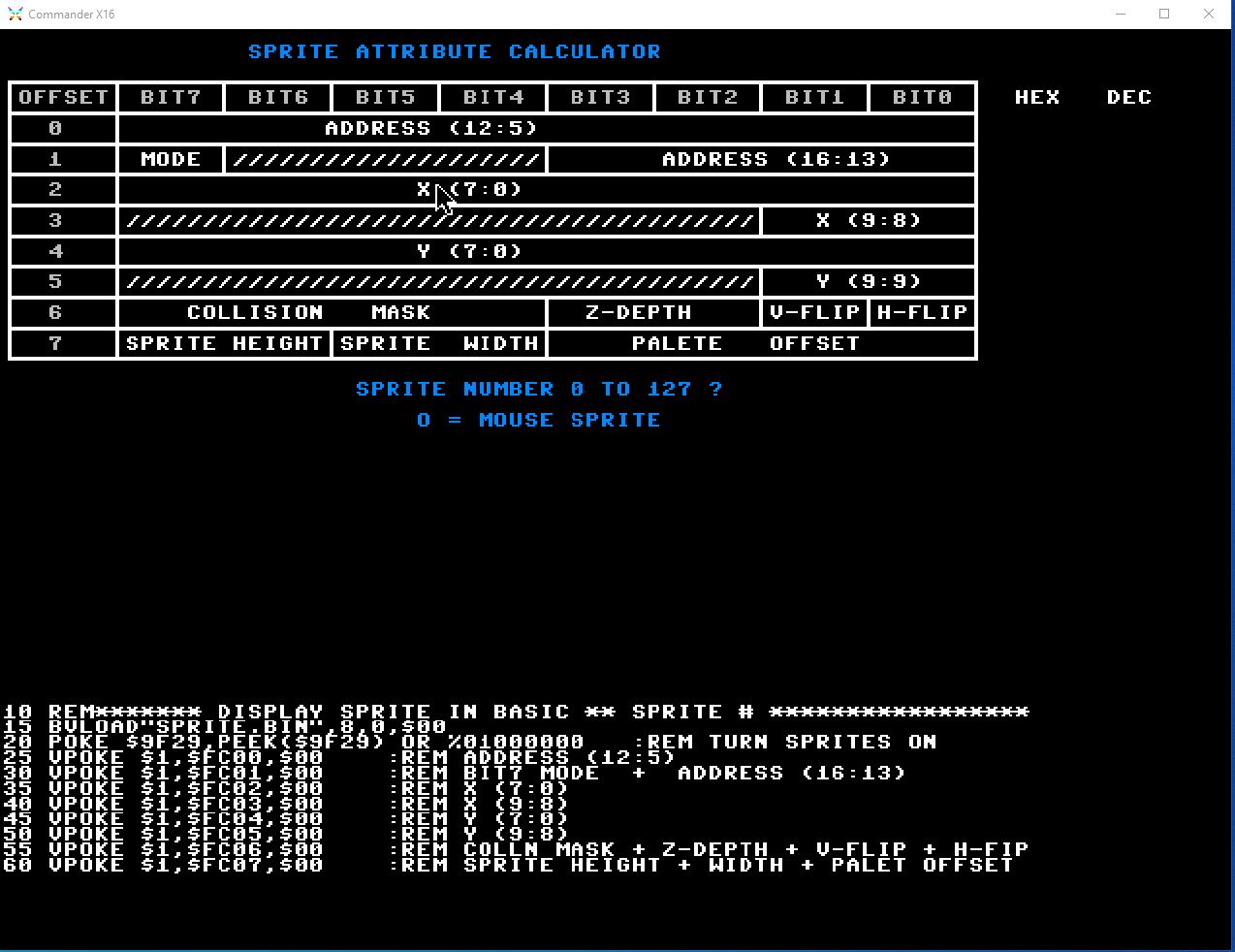

Plug in the 'Sprite Attributes' and it will give you the BASIC program to display that sprite.
Use your mouse to click in the grid to change the attributes.
Should be self explanatory enough if your learning how to use sprite's.
or need a BASIC program to display your sprite.
I Started making this a few months ago, and works great to get the BASIC program.
Ohh remember.... you can put a 'dollar sign' $ in front of a value to make it hex.
