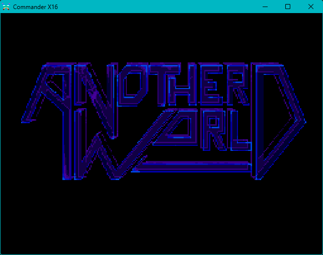

Screencapture: Yes I'm really bad at this game lol.

I believe the designer (Eric Chahi) got fed up towards the end of development and decided to just draw the rest of the game using bitmaps instead of polygons. So I had to code a bitmap decompressor. The game uses 4-bit planar bitmaps, which for anyone who is a modern graphics programmer can be difficult to get your head around. Basically the game stores each "bit" of the 4-bits, 4 sequential "planes". So for a 320x200 image, the first 32000 bits are "bit 0", then the next 32000 bits are "bit 1" and so on. Took me quite a while to understand. Then I had to do scaling from 320 to 256. I spent ages devising a bresenham-like accumulator scaling method when I realised I can just skip every 5th pixel when drawing lol. That said it's skip every 5th "bit" which is a bit trickier than it sounds. But now I have bitmap images in the game - there's about 6 or 7 images in total, including the title screen(s) and some later levels. Different versions such as the DOS version also have an "Interplay" title screen that's a bitmap too.

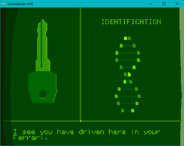

These screens were drawn from bitmaps.

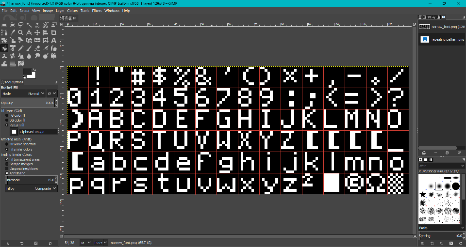

So for that reason, I wrote a new text engine from scratch. Because my game is 256 pixels wide I had to create a new font too. So I hand-pixelled a new 6x8 pixel font for the game, based on the Amiga/DOS game font. I then wrote a basic encoder/decoder for the font, and wrote a "display char" and "display string" procedures. The spacing (kerning?) on the text isn't perfect because there's no subpixel scaling, but it works fine for what it is - text is used rather sparingly in the game. I can use the original ASCII encoding rather than PETSCII or Screen Codes instead too.
